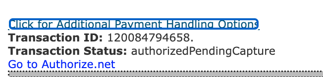

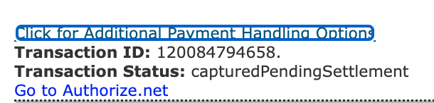

Note: In Zen Cart 3.x, the status of the order in real time is shown.
Pending Capture
Pending Settlement
